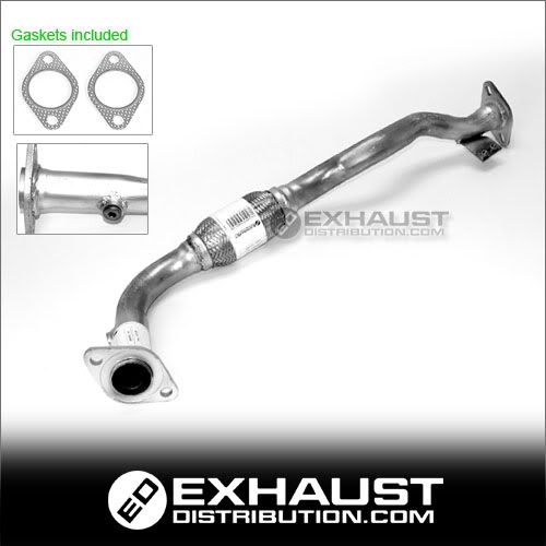

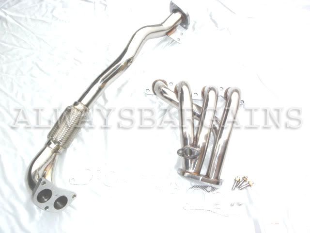

    My 93 rolla has come across a hole in the down pipe recently . I have priced the down pipe and they run about $120 bucks even on E-bay . But I came across Stainless Steel Headers with a down pipe for about $80 Dollars .
    I dont intend on boosting my motor or shaving the heads or making any kind of performance to it .
    I know people say headers run underneath hot .
    My question is " What would be the Advantage or Disadvantage if I go with the headers compared to Just leaving it Stock ??

    advantage of changing out header and downpipe is you will get better air flow as long as you don't make the pipe too large which can result in better performance but better yet, better gas mileage. Downside is it can definitely get hotter and worst case scenario = trunk goes into flames. lol. actually everyone i know who have changed out their header who also like to drive at high rpm's a lot have had problems with the header a lot, whether the header cracks or the gaskets or flanges warp and leak, etc which can cause a lot of headaches.
    bottom line IMO its not much worth it, corolla unless turbod is gonna be slow... 5HP that you will get at most with it not really worth the headache like drunksaru said.

    those cheap noname headers suck anyways. Everyone say the flex pipe start leaking after a while. best to get a replacement OEM downpipe or just get the hole welded up.
