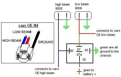

    H4 to 9006/9005 Conversion (98-00 to 01-02 conversion)
    Here is the diagram for the headlights to work like factory 01-02 Corolla. It works even with HID's.
    I hope this can help you, for those with the problem.
    Also you have to change the headlamp fuse to 20
