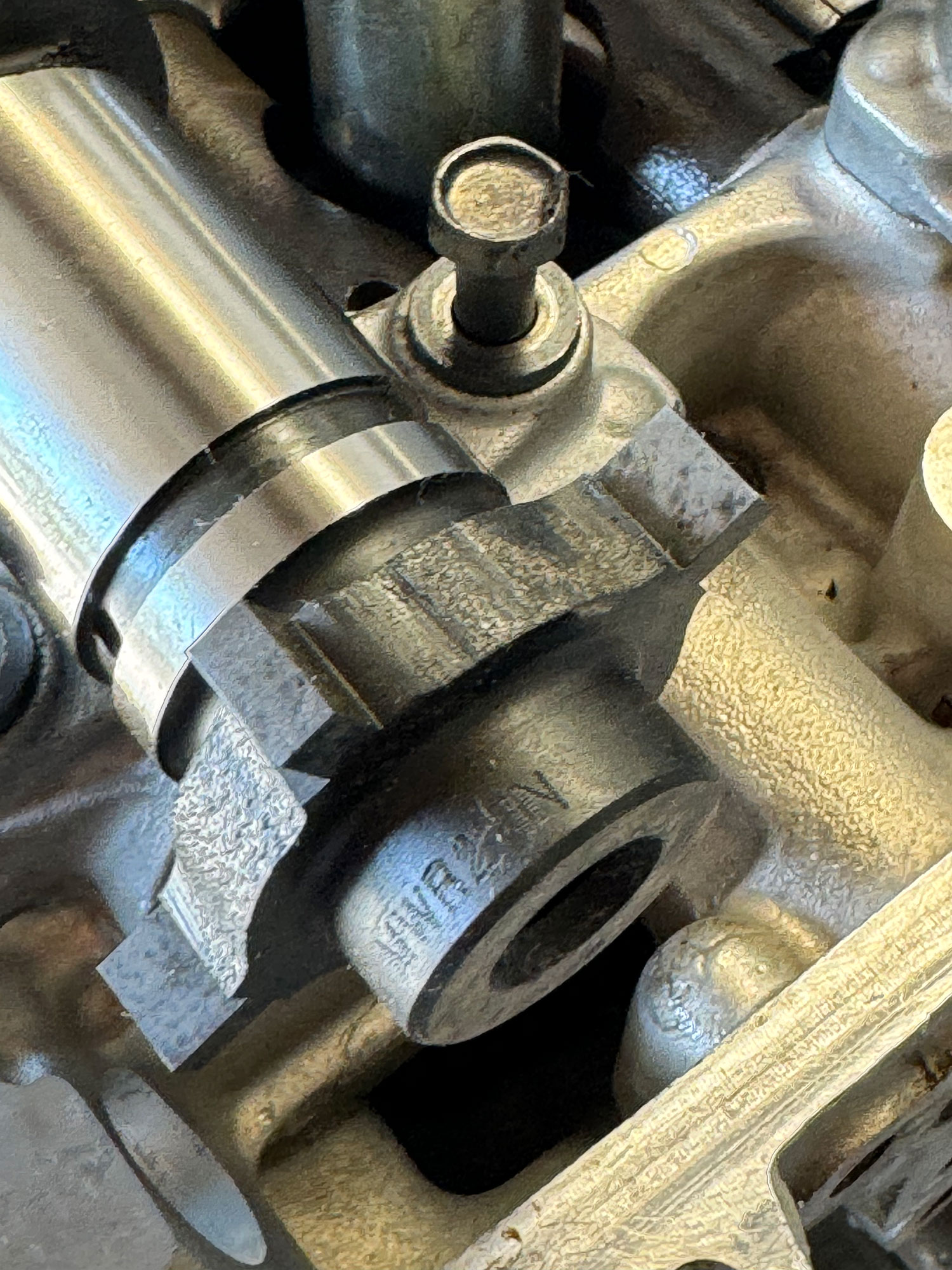

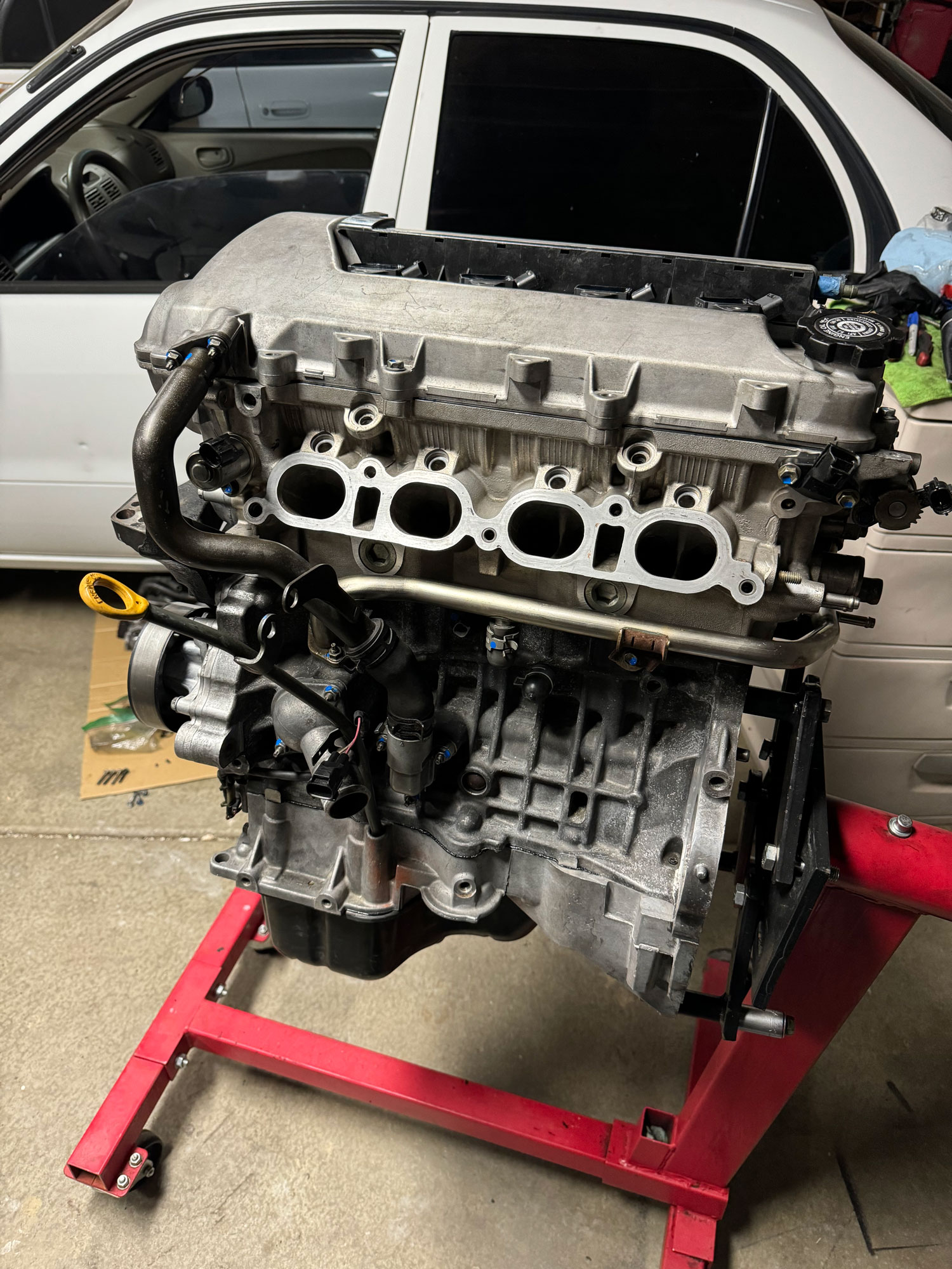

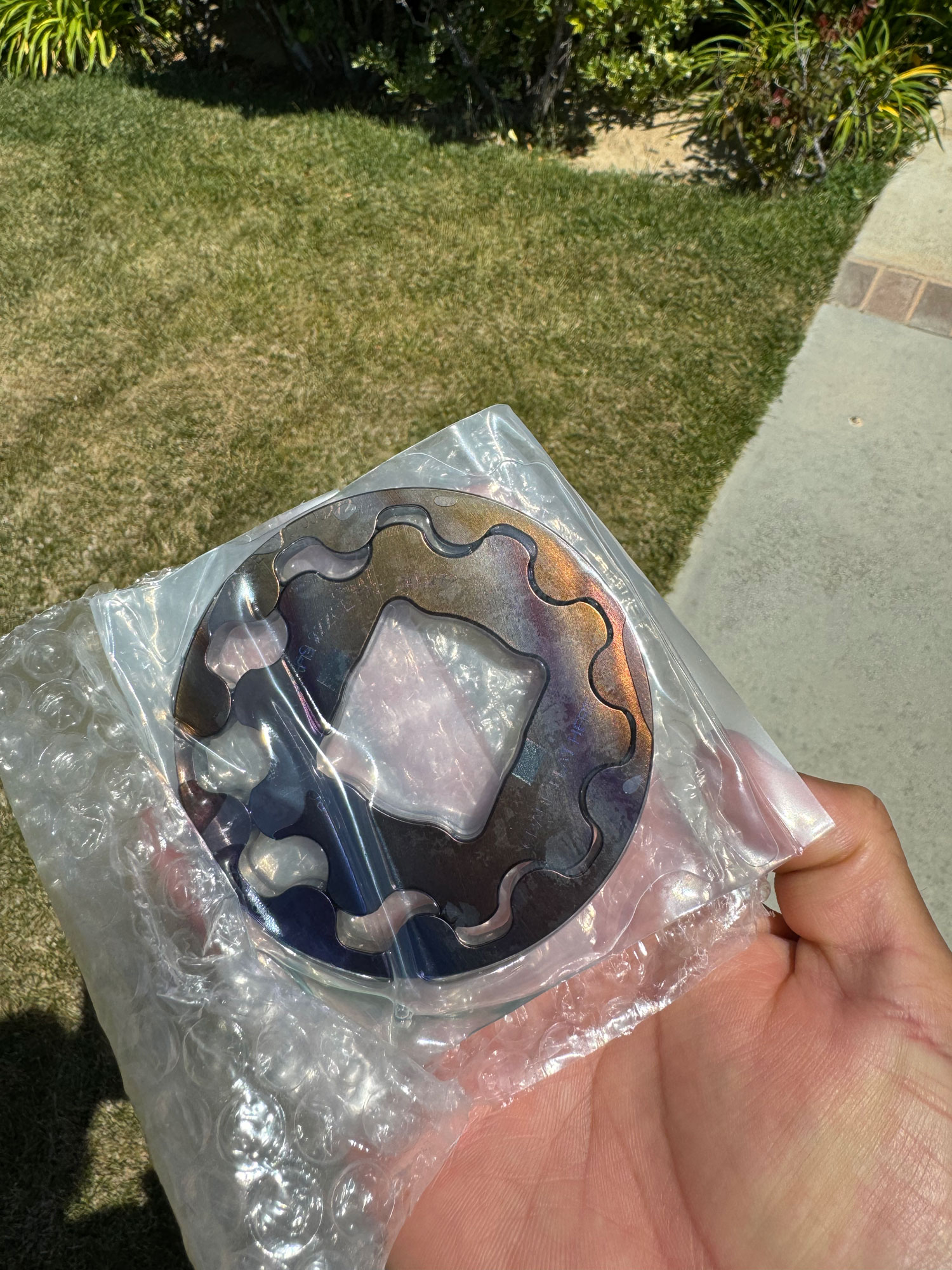

    Little update : Sadly, I bent a valve in my engine I swapped over from a once 2zz swapped corolla. Current guess is I wore down the rod bearing from a trackday or previous owner did. But its salvageable so that will be next on the rebuild list.
    So a kind of half built motor went in
    -ACL Race bearings Rods and mains
    -MWR stage 2 Cams
    -Boundary Billet heat treated oil pump
    -Oil pressure shim(For racing needs)
    And a bunch on new oem bits

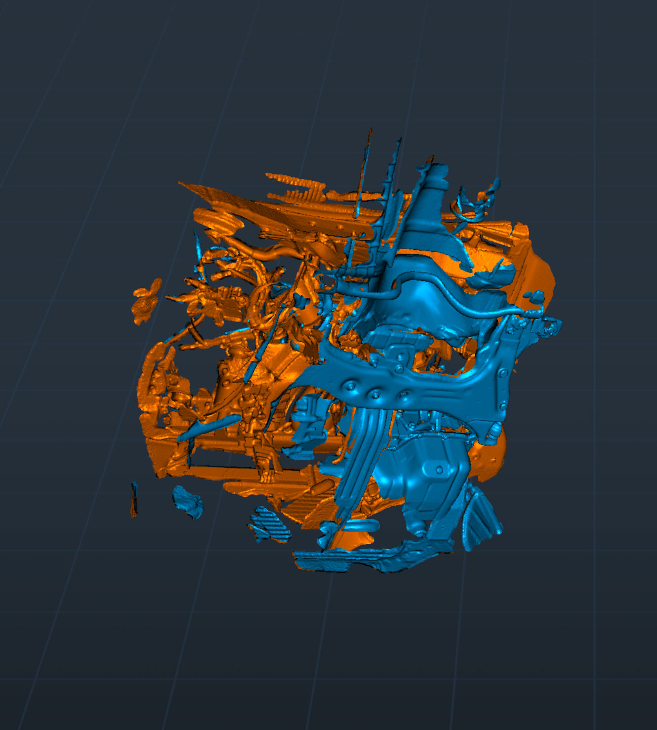

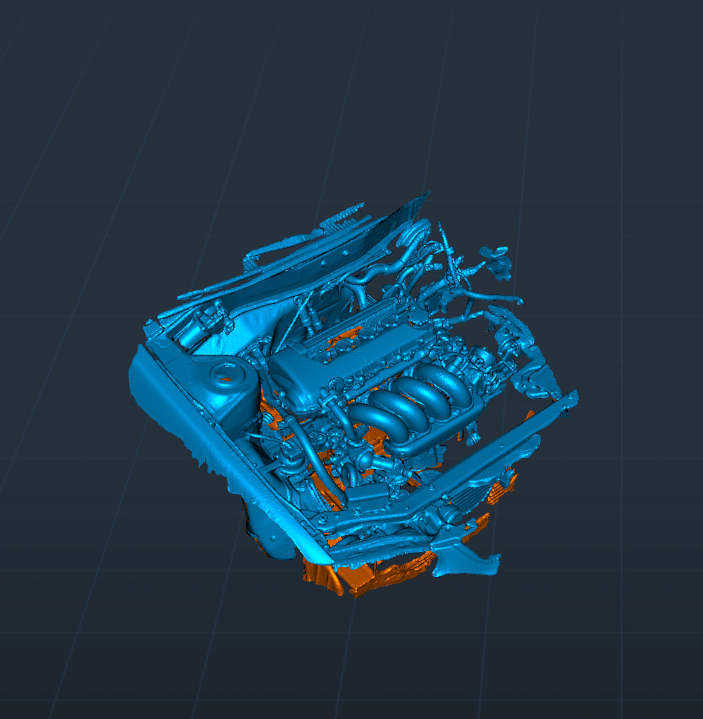

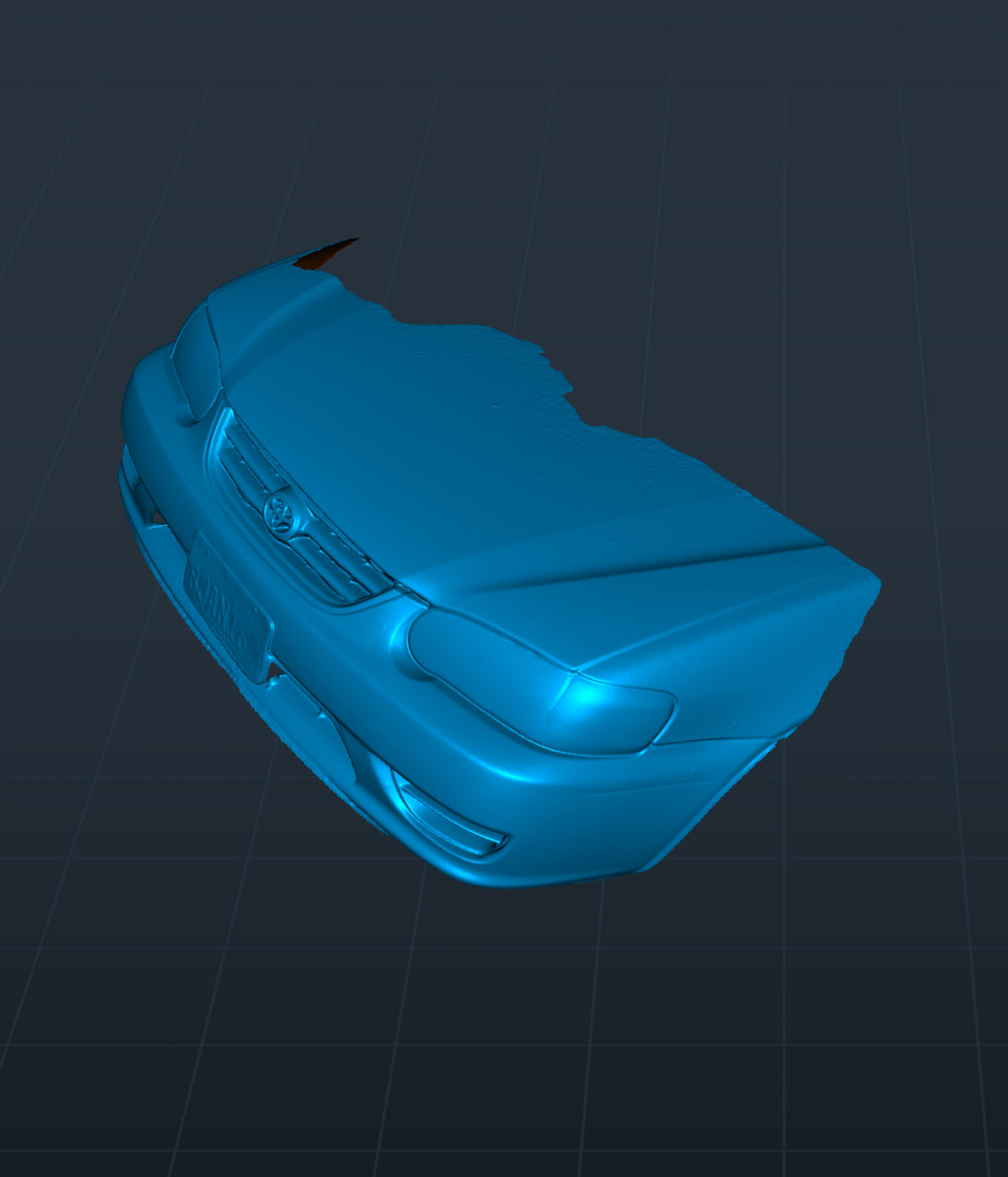

    Outside of mechanical work. My new 3D scanner came in! Now I can knock out all the cool work I have been wanting to do but had a technology handicap. Here are some sample scans i have been able to knock out so far.

    Great update. What's the deal with the oil pressure shim? What made you give it a try? Are you going to actually measure the difference in pressure before and after?
    Wanted to try something new. I have a ton of old logs of oil pressure to compare to. So once this motor is past break in i'll probably post a side by side.

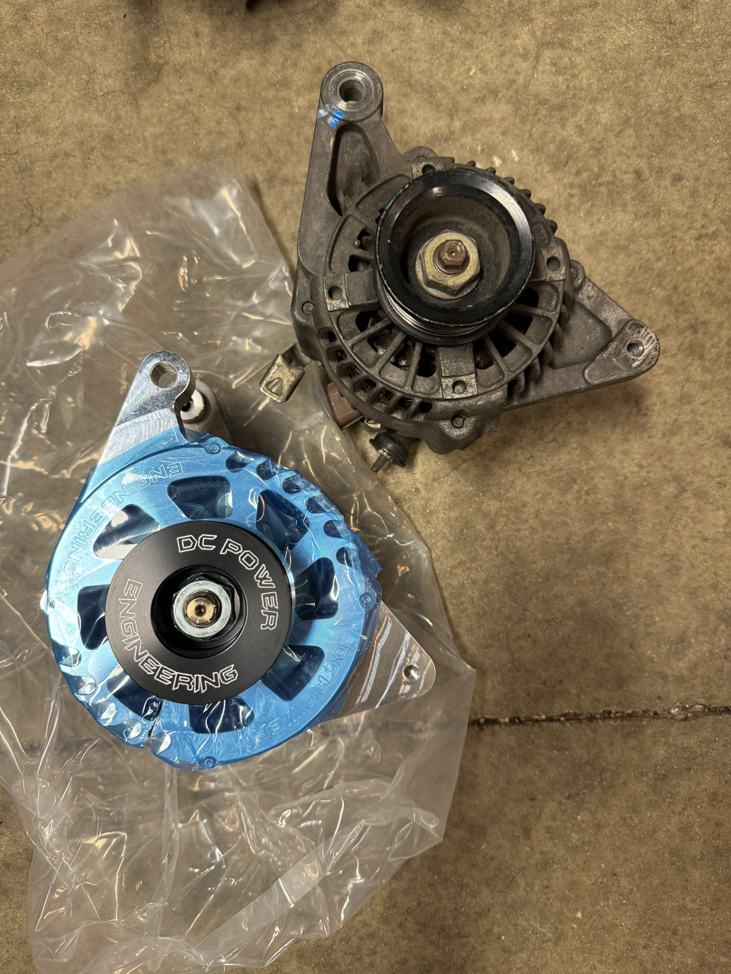

    Finding time has been pretty hard to knock out things on the car. But lately I've upgraded my alternator to help support the current electronic package.

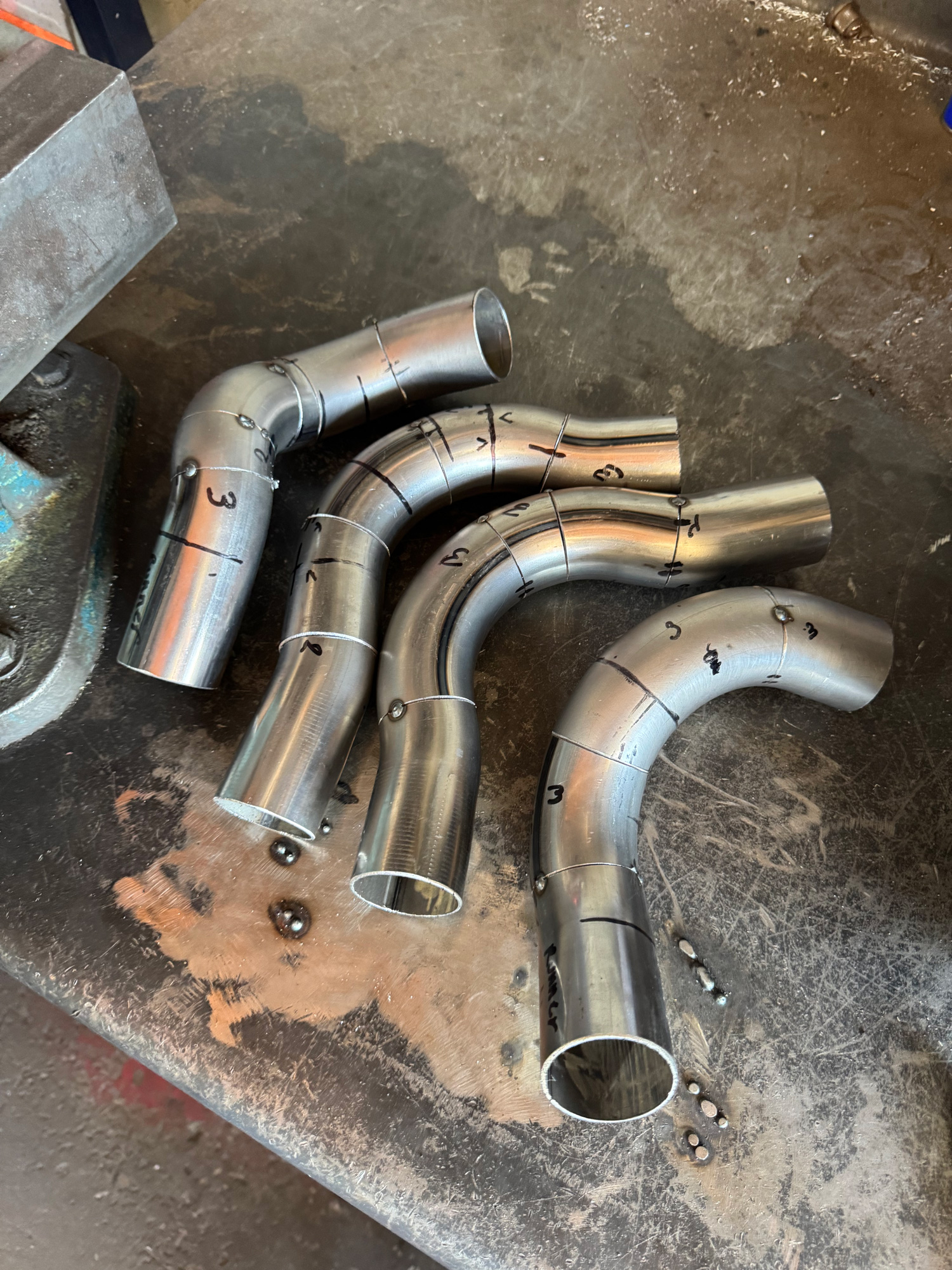

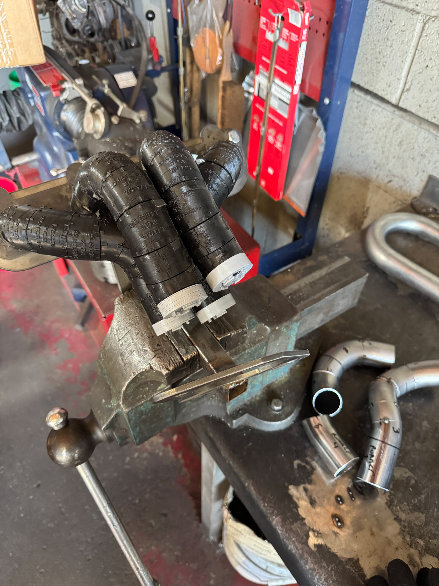

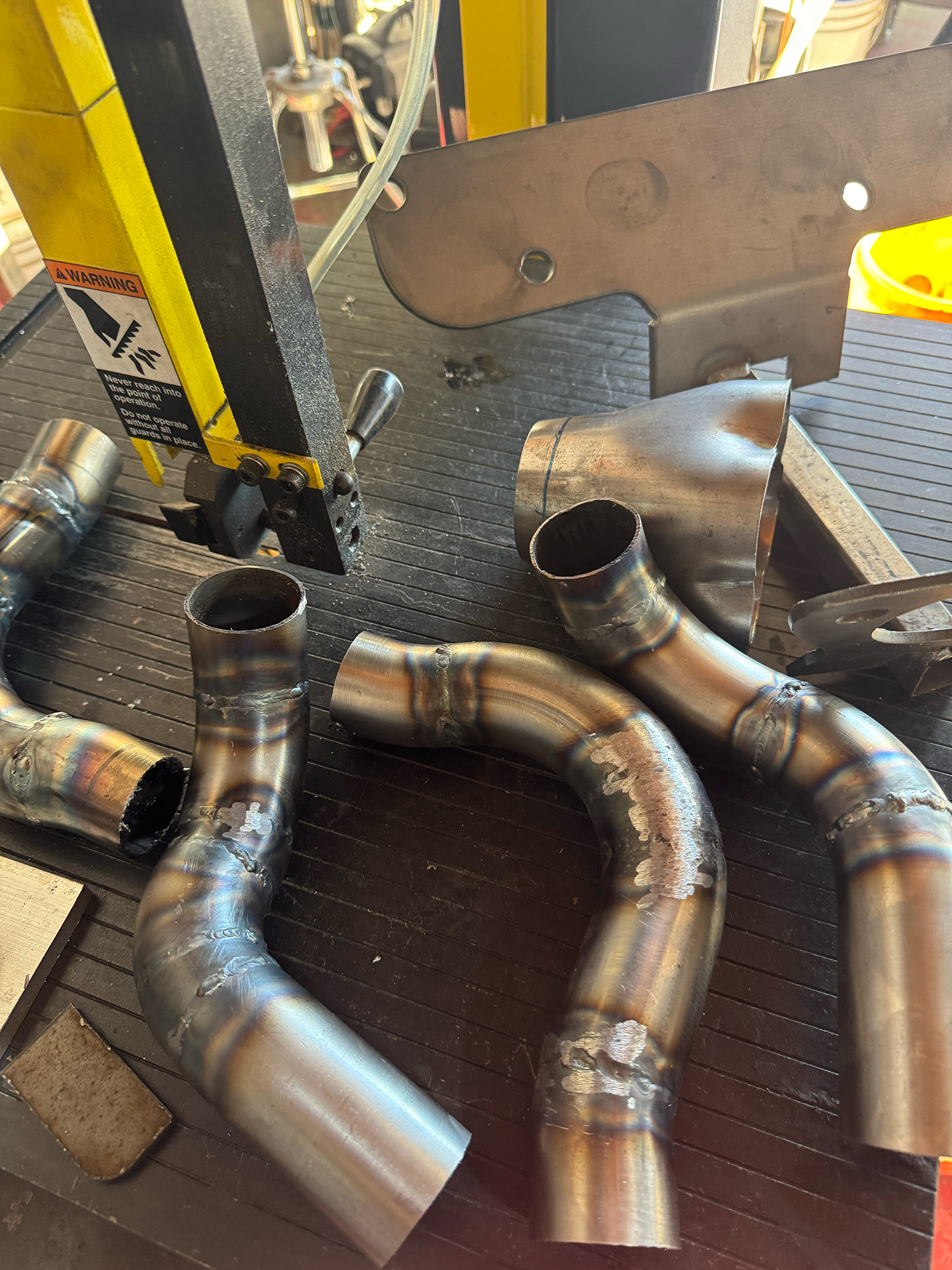

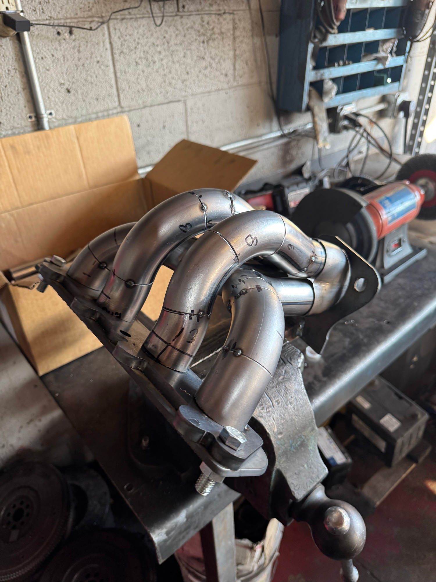

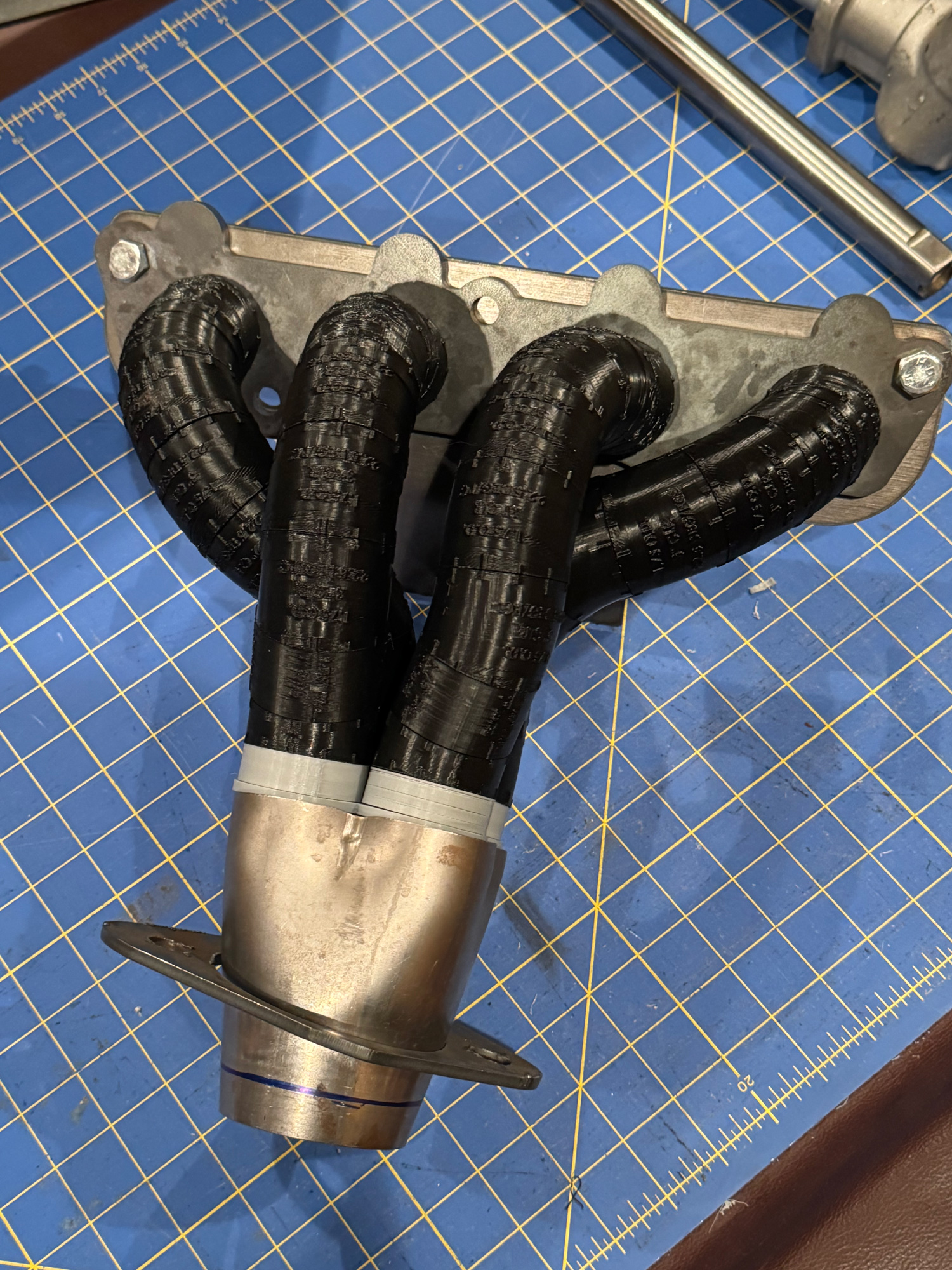

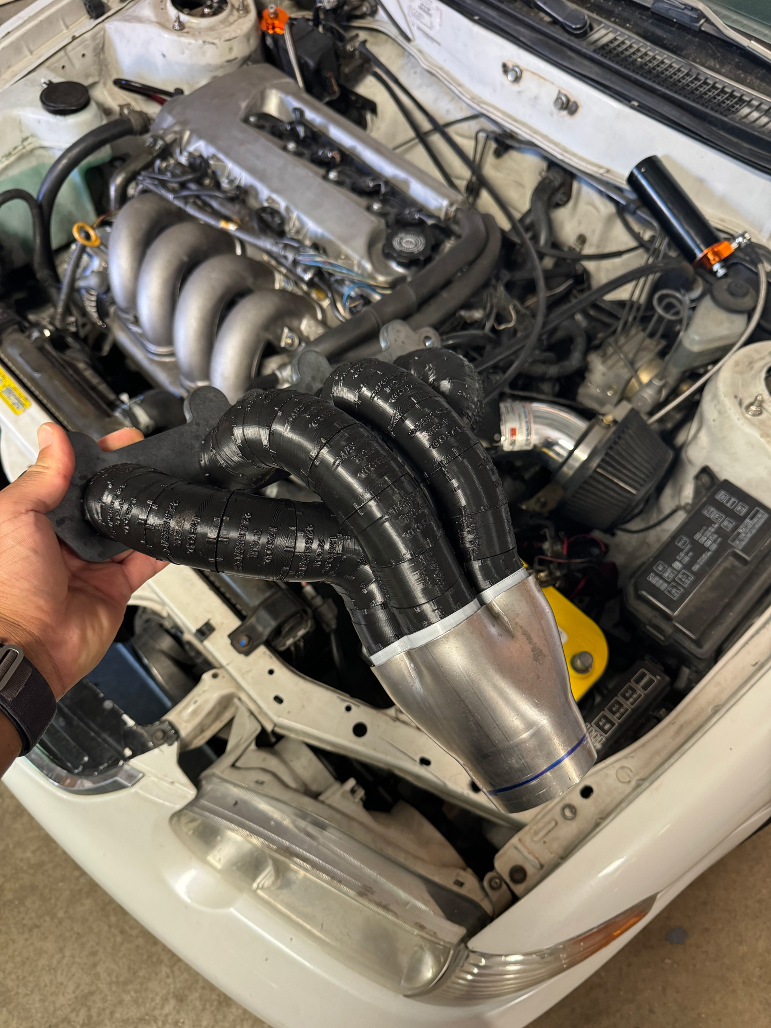

    So, I've always wanted to make my own header specifically designed for this configuration and not modify some existing one. This is my attempt with some help from modern tech. For my first time ever fabricating, I'm pretty happy with it but some pipes didn't fit up as well as I wanted too. One section had a little more of a gap than i wanted.

    Very nice! I never saw the header fabrication process like that before, so that's cool to see.
    Thank you ! Yeah this has been a interesting skill and challenge to take on for my first time ever lol

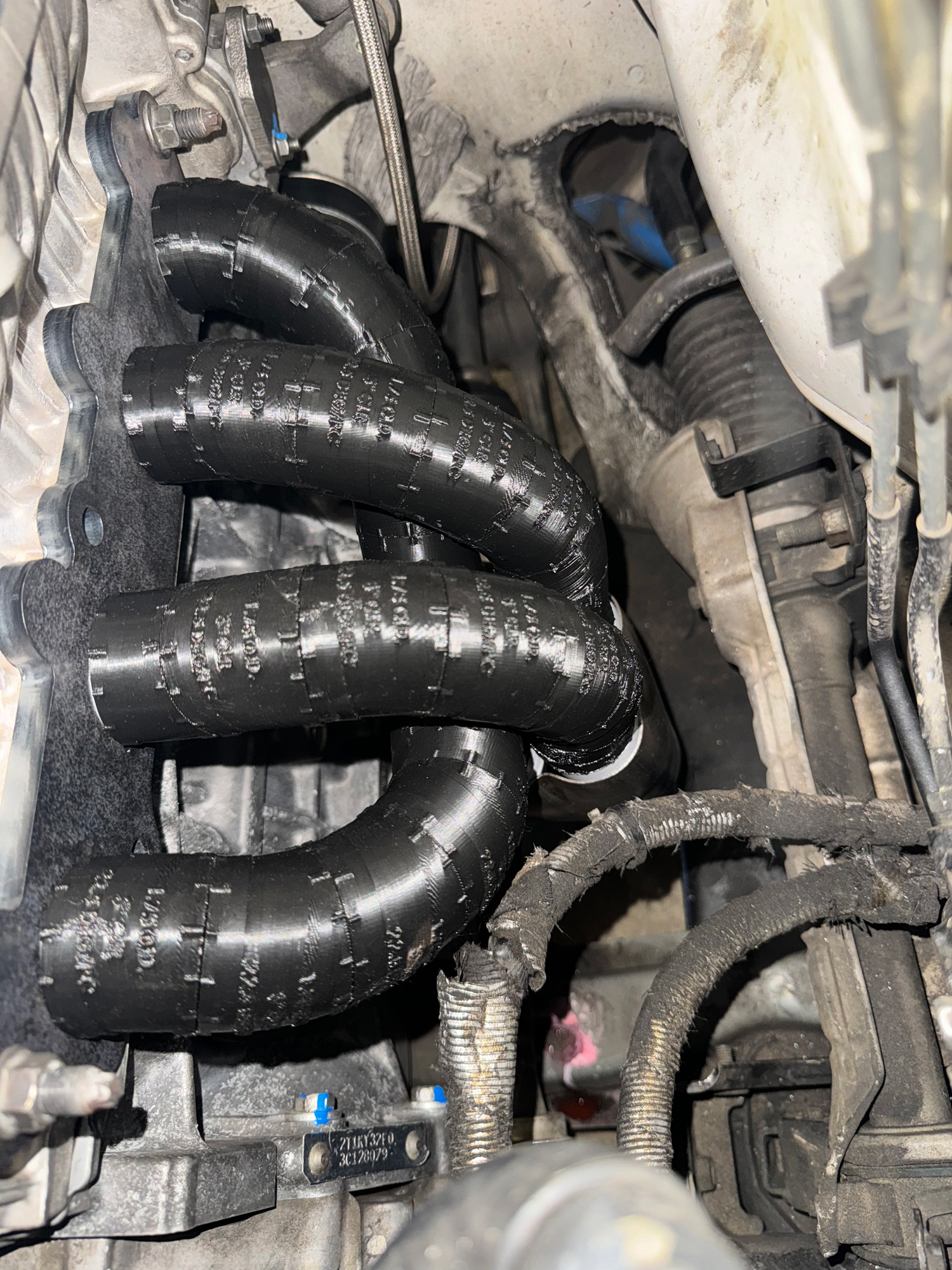

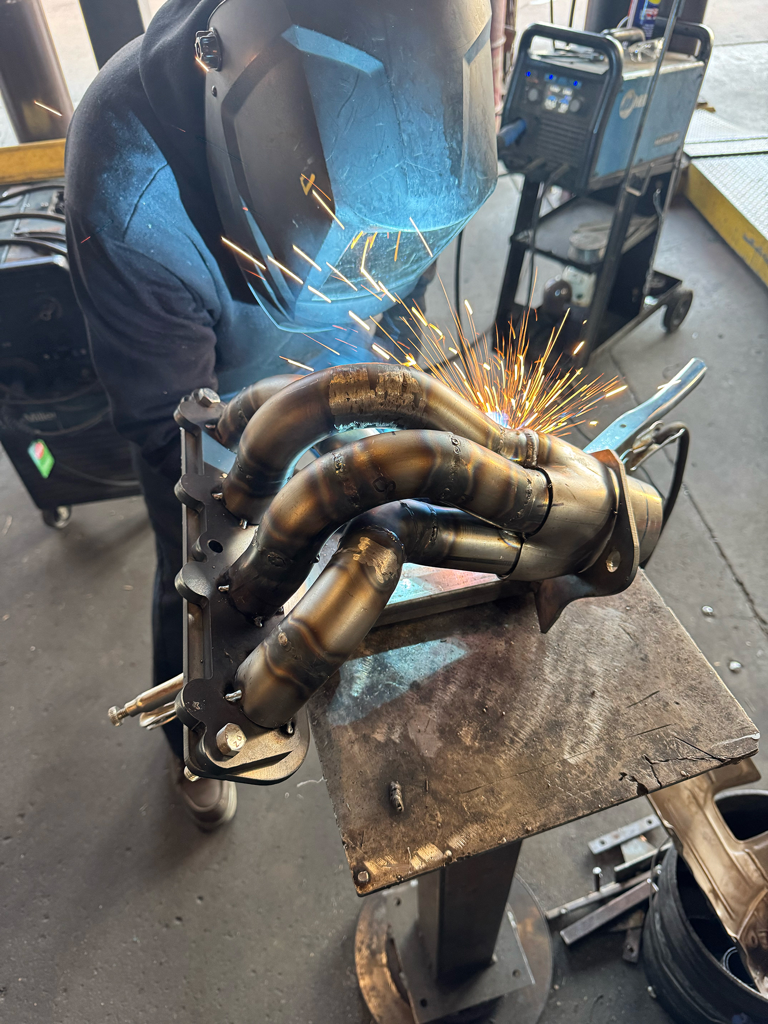

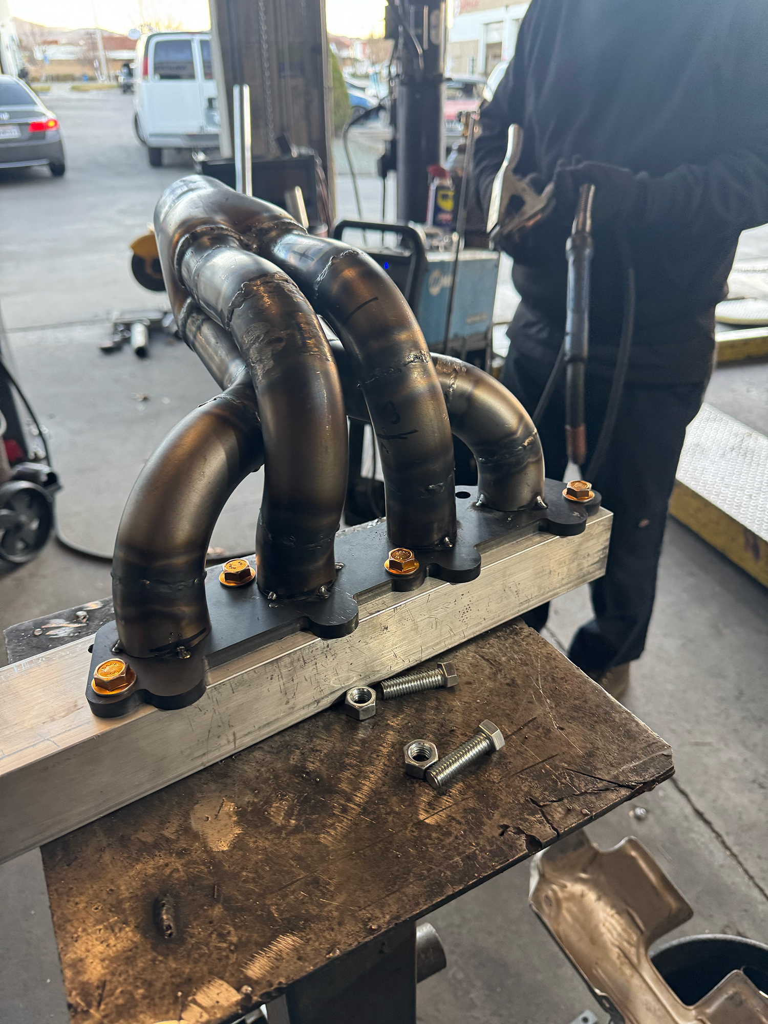

    Finally, there has been some progress on the Corolla. My prep work failed, but I pushed through and knocked out the runners. I gave in and MIG the rest of the header. This is the first shorty 4-1 that steps down from a 1.75 runner to a 3-inch collector exit to 2.5 exhaust. Not bad for a first proof of concept.
