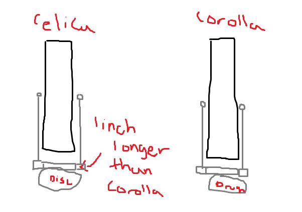

    and thats what im talking about....where it mounts from the spindle/knuckle whatever its called its longer for the celica...i was thinking maybe welding a spacer on the inner mounting point from the corolla to match the size from the celica...

    ah, those would be the lateral links / control arms. the trailing arm is the one that connects to the bottom and goes forward to the car. hence the term trailing arm. still, 1in is a big difference.
    ohhh i see....well i guess ill have to sit with my GT fronts....which is fine since im really just aiming for the 5 lug conversion...
    sorry for the name confusion, dont know what these things are called...
    but yea its like 1 inch longer,
    I saw the celica at the junk yard and thats how it looked to me ^^^
    what i was thinking about if its a problem then i was going to remove the big arm thing thats holing the rear disc an welding in a longer spacer to fit it.

    AH! so the arm length isnt the issue but the actual boss width is on the knuckle. thats an easy fix really. spacers is one way. another would be to have the boss on the knuckles machined down to the same width as the corolla ones. either way shouldnt be to expensive. with the spacers, just make sure you have plenty of room to get everything in there.

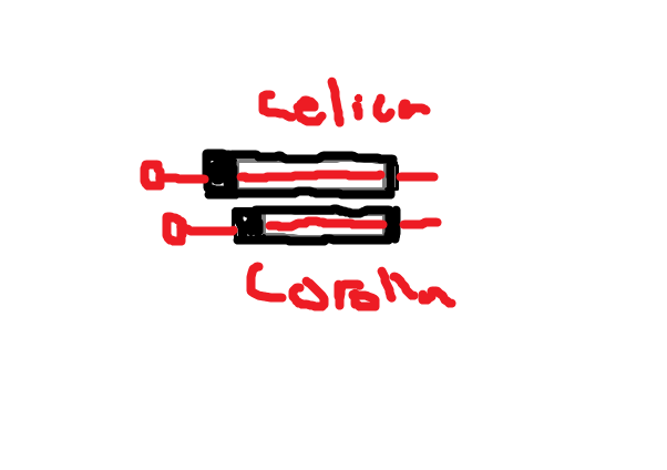

    thats another thing....you wouldn't be able to cut them because both have like a opening in the back of it and cant be cut because if you cut it to length the bolt wont be held inside anymore....the red line is the bolt
    what i was thinking was getting a simple nut from home depot and using it as a space just like you said but the welding part is just simple aswell...

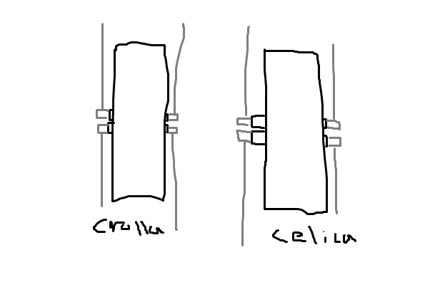

    and here is th corolla pictures vs the celica rear disc...
    celica/camry rear disc
    Im thinking about welding an additional piece on the struts and drill a new hole...

    i take it the first pic is the strut to knuckle?
    looks like the control arm mounting boss is 4.5 in for the corolla and 5 7/8ths in for the celica? am i seeing that right? so an 1 1/4 in would have to be shaved off on the celica boss.
    Added: Mar 24, 2013 4:34 AM
    the actual control arm lengths shouldnt be an issue, since your not going to use those. you should be retaining the corolla ones.
    yes.
    Im not going to tamper with the mounting boss...my uncle said a simple nut spacer can do the job since their is not much stress in that area.
